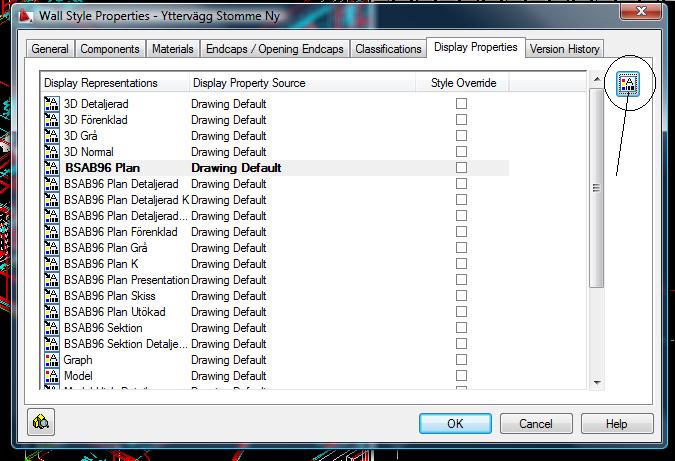

Direct Link To This Post Posted: 02.Mar.2010 at 16:00
You shuold be able to control how the material on your wall behaves.
Wall Style Properties>Display Properties, Select wich Display Representation and then click the "A" in the corner.
Thats were you control it.
//Tobias
