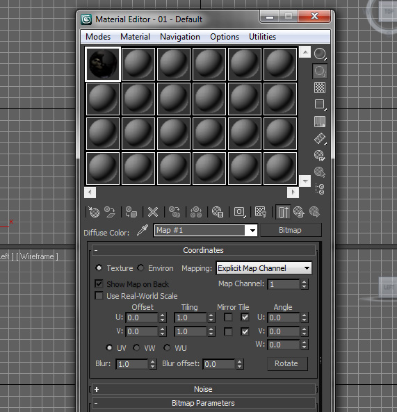

You can make adjustments to your bitmaps parameters in the "Coordinates" section of the Material Editor.
Offset adjusts the placement of the bitmap on the models surface
Tiling adjusts the scale of the bitmap in UV space
Angle adjusts the rotation of the bitmap in UVW space

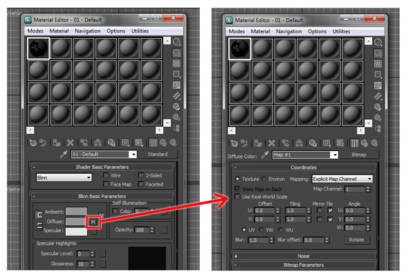

There is no Coordinate section shown. My only options are
Shader basic parmeters
Blinn basic parmeters
extended parmeters
super sampling
Maps
dynamics properties
and direct x shader
mental ray connection

That's because you're not in the right area of the Material Editor. After you load your bitmap, click on the little button with the "M" on it, next to Diffuse.
