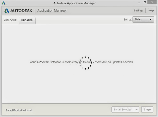

Autodesk Application Manager hangs reporting no updates.
A - answer The "Application Manager" component in Windows status bar reports no updates of Autodesk products (or a single update) and its dotted progress-wheel keeps rolling without any results.
The latest update of this component was not completed successfully. Uninstall "Autodesk Application Manager" and re-install the latest version of this software from Download (version 4.0.66.0 or higher).
Also make sure you are logged-in in the Autodesk A360 Sync component (systém tray).
