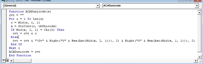

The code of the VBA function (Alt+F11 in Excel, Insert>Module):
Function ACADunicode(s)
cvt = ""
For i = 1 To Len(s)
 c = Mid(s, i, 1)
 x = StrConv(c, vbUnicode)
 If Mid(x, 2, 1) = Chr(0) Then
  cvt = cvt & c
 Else
  cvt = cvt & "\U+" & _
  Right("0" & Hex(Asc(Mid(x, 2, 1))), 2) & _
  Right("0" & Hex(Asc(Mid(x, 1, 1))), 2)
 End If
Next i
ACADunicode = cvt
End Function

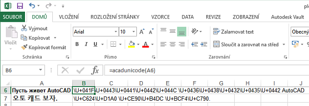

You can invoke in Excel in a standard way, similarly as other embedded functions - e.g. =ACADunicode(A1) - converts the text from the cell A1.

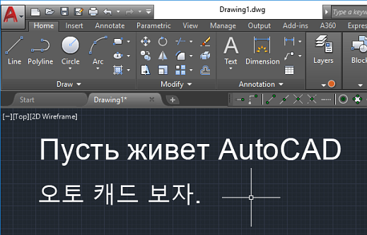

The resulting text in AutoCAD:
