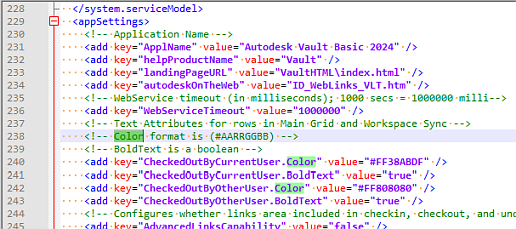

If you switch your Autodesk Vault client to dark mode, you may need to adjust the color or style of the released files (from the default dark blue).
Follow these steps:
  • Close your Vault Client app.
  • Use Notepad or Notepad++ (in Administrator mode) to edit the configuration file Connectivity.Vault.exe.Config or Connectivity.VaultPro.exe.Config in the folder of your Vault version (Basic, Professional) - e.g. C:\Program Files\Autodesk\Vault Client XXXX\Explorer.
  • Locate the following section and change the setting of the "Color" parameters - CheckedOutByCurrentUser.Color (checked-out by you) and CheckedOutByOtherUser.Color (checked-out by others).
  • Save the file.
  • Restart the Vault client and you will see the difference.
The color code is in the format #AARRGGBB, i.e. in front od the RGB color hex code (see e.g. the color converter) prefix the code FF for opaque colors. For the RGB codes - the higher the number, the lighter the color hue.
