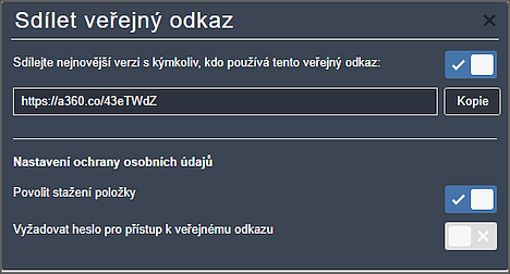

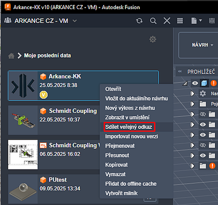

Let's say you have created such a link from the Data Panel or from the File > Share Link menu:
and now you want to disable that link.

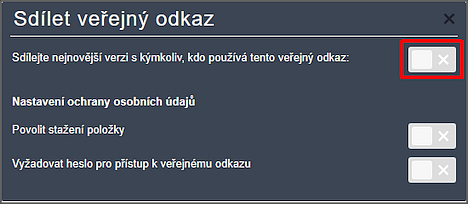

Open the Data Panel again, find your design file (document), right-click on it and select "Share public link" again from the context menu:
In the "Share public link" dialog, turn off sharing:

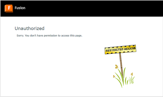

Existing users with the original link will immediately see the following page when they click on the link, instead of opening the design:

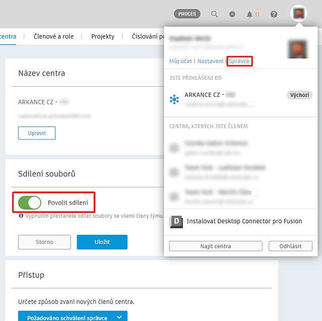

To completely disable team sharing, as an Administrator in your Fusion Team Hub, go to Account administration and turn off the "Enable Sharing" option:
