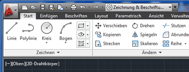

E.g. with the language option "de-DE" (and downloading the German Language Pack) you will make a German version from your AutoCAD:
German AutoCAD
