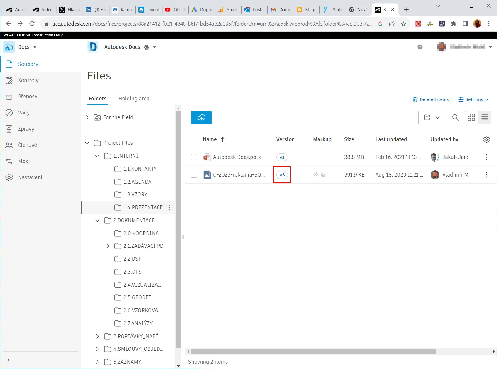

A brief version history is displayed in the window when you click on the version number button - this will show just the author and the date each version was uploaded (click for larger images):

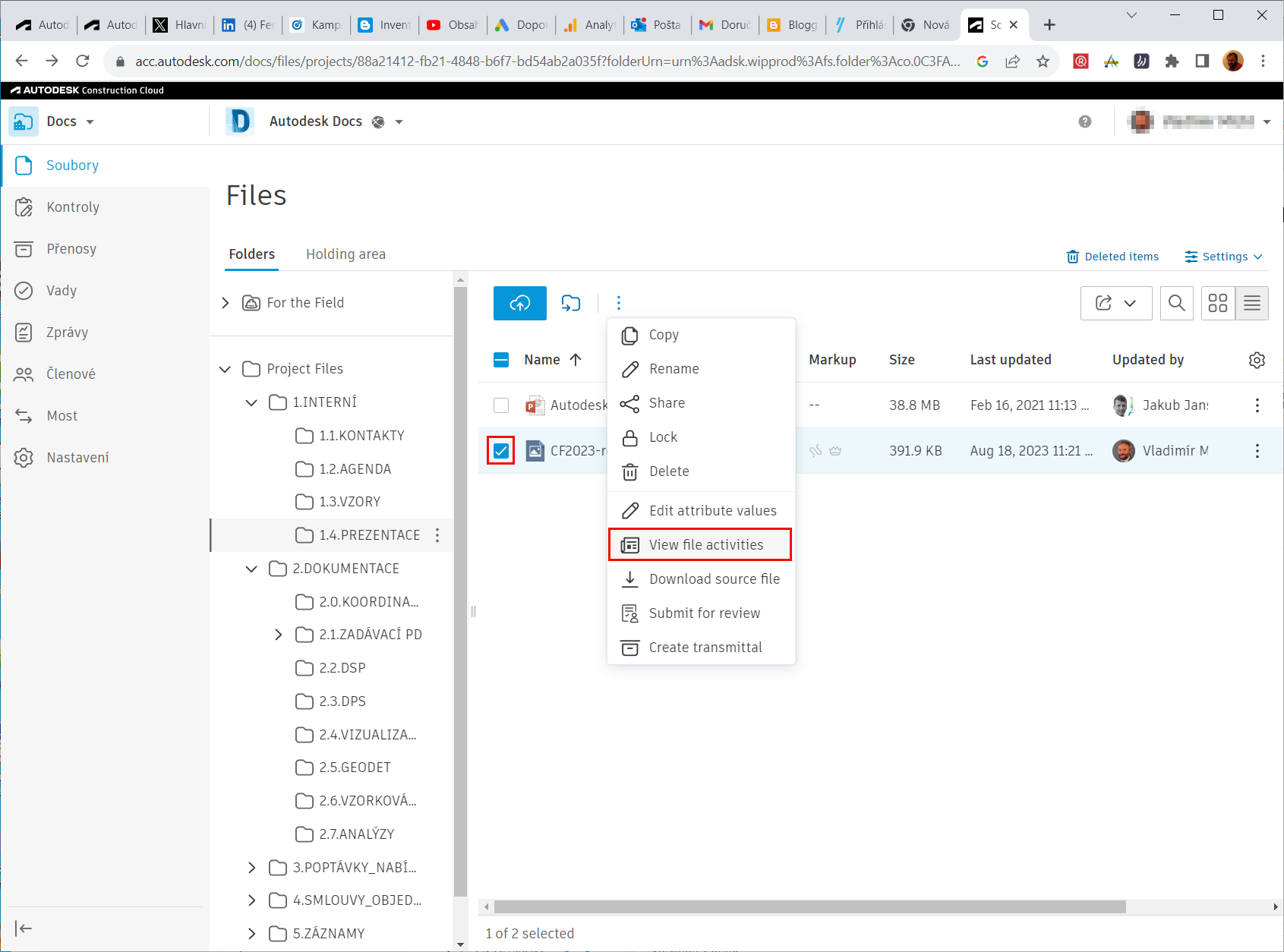

For a more detailed log of all activities on a given file, invoke the "View file activities" function. This can be found - after selecting the document - in the top file menu (three dots):

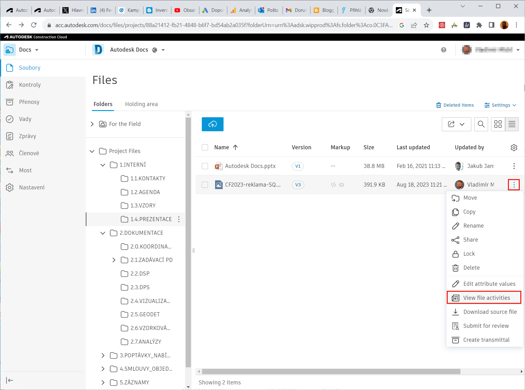

Or you can invoke it from the context menu on the particular document (the three dots menu on the right):

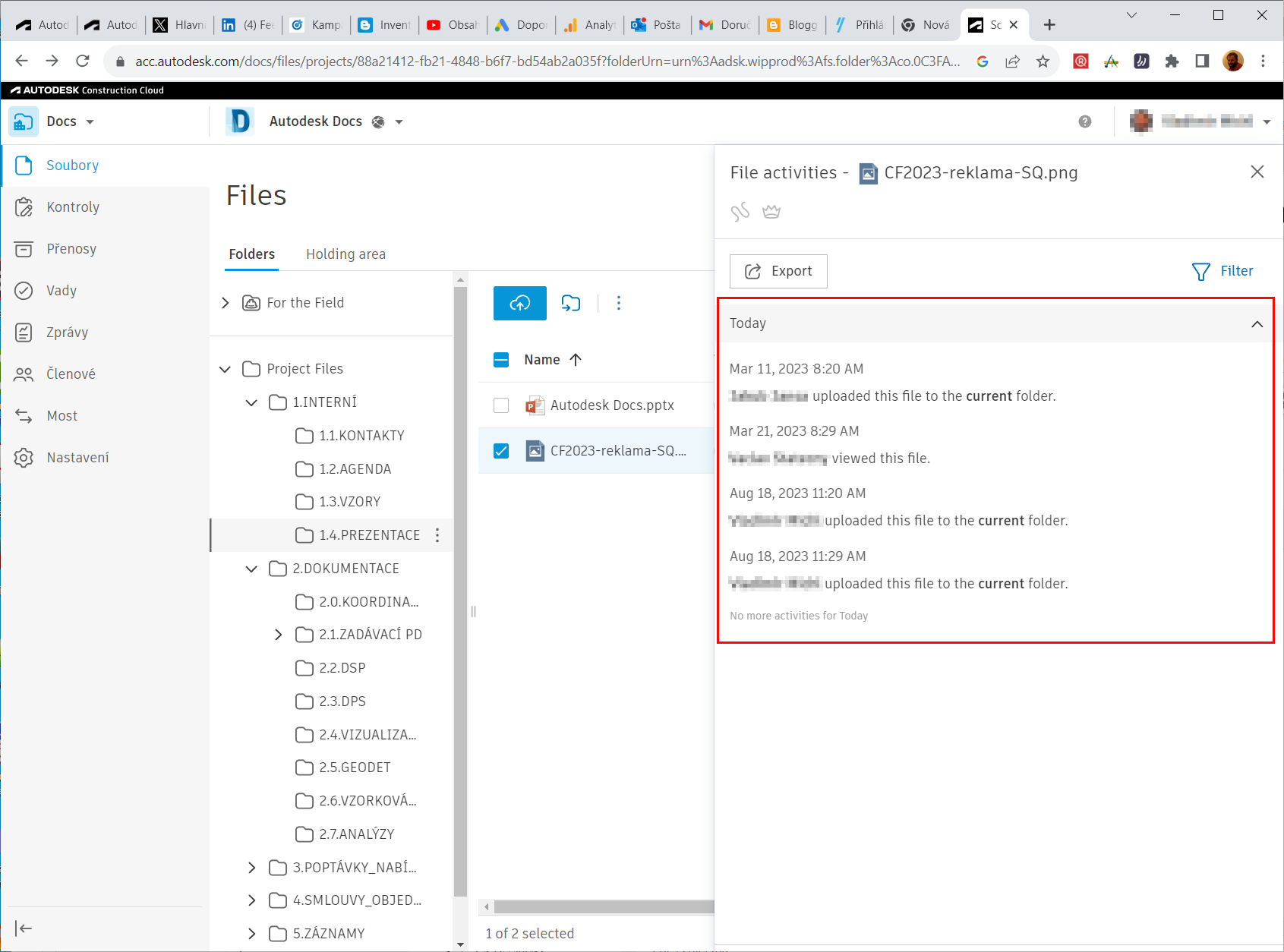

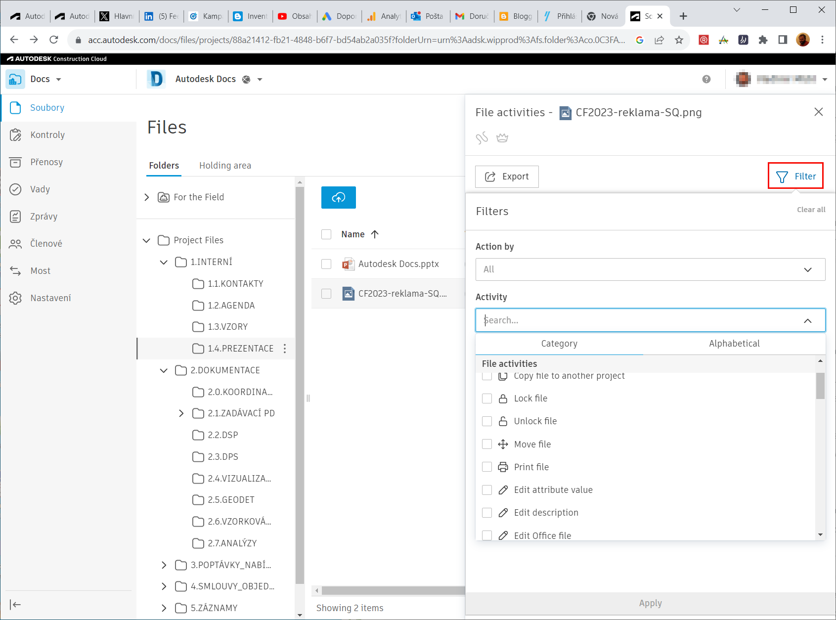

You can filter what type of actions you want to list (upload, rename, view, share, export, comment, delete, join into another project, approve, lock, markup, comment...), actions made only by a certain person or only within a certain time range:
filter - author
You can then also save the activity log output to a CSV file e.g. for Excel:
