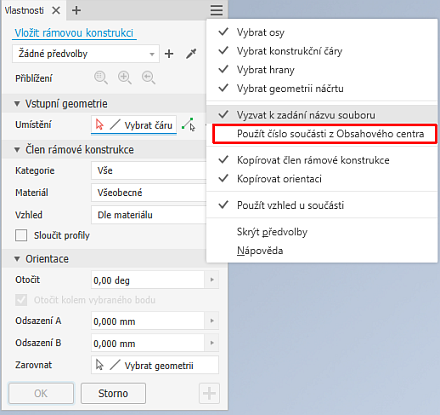

Part number from the Frame Generator is not transferred to the Part Number iProperty.
A - answer When I create a frame using the Frame Generator, the new part is inserted and named according to the selected numbering scheme, the part is inserted into the specified folder, but the part name is not written to my "Part Number" iProperty.
When inserting the part, use the setting with the "Use Part Number from Content Center" option unchecked:
Then it doesn't matter if the value is filled in the CC or not. It will not be taken into account when filling in the part number property, thus ensuring that the Part Number = File Name.
