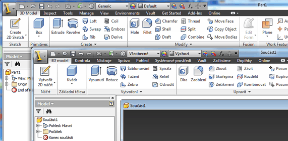

So you can run a single Inventor installation even in multiple languages at the same time:
Inventor2013
