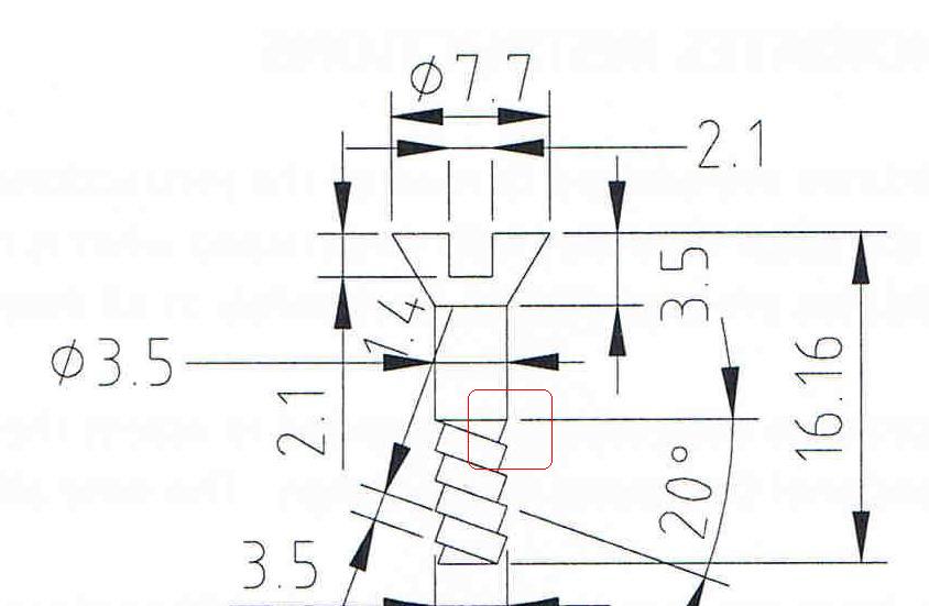

Thank you JC and Kent,
My problem is that I don't like things that aren't 100% correct (or should I say 'Perfect'). I know now (JC-I very nearly put here 'why you cry' here) that I should just go on the dims that my tutor has given me for the screw and not how it looks to the eye. To clarify- it seems that I have just been too meticulous about it. Apologies.

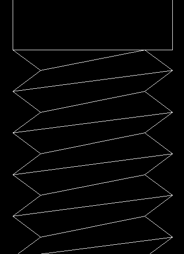

If the corners of the tilted rectangle are supposed to align across one red line, use the ALIGN command, aligning the diagonally opposite corners of the rectangle with the ends of one red line, and answering Yes to the question of scaling the result.
But it seems a little strange to put a lot of detailed effort into getting something that does not look very much like real screw threads at all to be "just right."  And has anyone else noticed that it's reverse-threaded?  Is it supposed to be?  Something like this, while not really completely correct either, would be a whole lot closer.

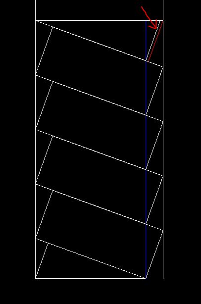

Direct Link To This Post Posted: 17.Mar.2014 at 10:58
The distance between the two vertical white lines is 3.5.
The blue vertical line represents the lower right hand corner of our rectangle.
The white diagonal line at the top represents where the partial rectangle should be.
The red diagonal line is where the line is drawn in the diagram.  The difference between the two diagonal lines is 0.0739.  If you were looking at the drawing after it was printed you would not know the red line was in the wrong position.
My advice...put the line where your teacher expects to see it based on the diagram and move on unless you have a mop of hair that rivals a sheepdog.  Otherwise you'll spend 1 hour doing the drawing and 16 hours worrying over it.

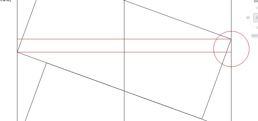

Direct Link To This Post Posted: 16.Mar.2014 at 22:06
Hi JC,
But you see where I have highlighted in red, below, is so different to what we would see if I chose the bottom red line on mine:
Do you see what I mean?

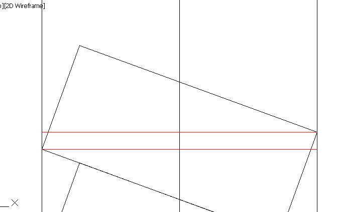

Originally posted by Bobdob Bobdob wrote:
JC, neither of these cut off points (in red) seem to correlate perfectly with the drawing exercise I have?
Use the lower of the two lines.
