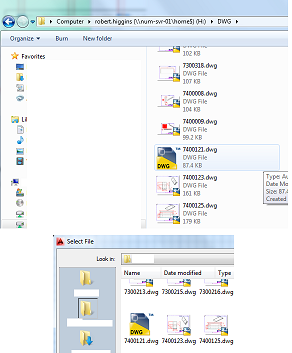

Yes John it did turn out to be association I had tried it. Then I was told to associate the dwg to any other program do a reboot then associate dwg back to AutoCad this fixed the problem. The select file in the system reg. brings back the preview window and the guy on the other forum did not know why this works but only that it does. In most cases he stated that association without the above steps works.
So in short if using windows 7 pro if you get Icon only and not a thumbnail. First associate the dwg files to any other program then reboot you system and then associate the dwg files to AutoCad then you get the drawing thumbnail back.
