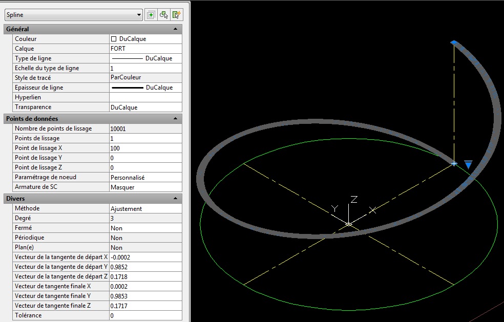

Here we are, also OK in the plan view.
I would have eventually questions about "vecteur de tangente" Départ et Finale but it's already a miracle.

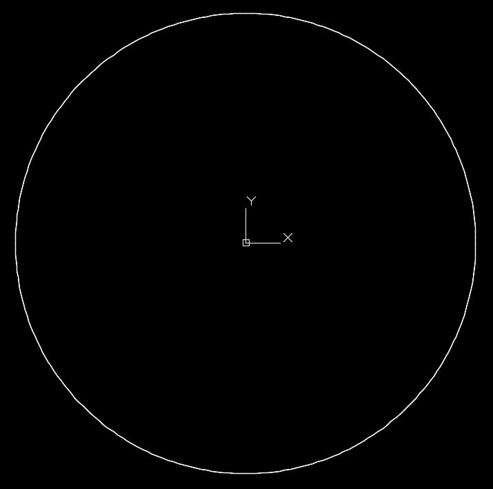

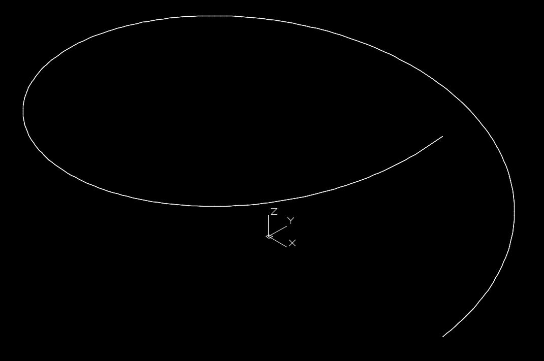

Direct Link To This Post Posted: 28.Apr.2017 at 12:35
Are you saying you don't know how to use the program provided by scj?
In my test of the program it appears to run on its own.  I think the user can change the accuracy, height, and radius by editing these parameters found within the body of the code.
(setq acc 10000)
(setq height 100.0)
(setq radius 100.0)
Using the presets I got the following results (plan view / SE isometric view):
