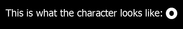

Originally posted by Kent Cooper Kent Cooper wrote:
.... the 0xA3 character in the Wingdings font looks pretty much just like that ....
For some reason I couldn't get it to work using typical Unicode "\U+0xA3" format as a text element in a linetype definition, as I had hoped, but that turns out to be the British Pound sign in most fonts.  I see that waynelem didn't say whether the rings alone are what's wanted as John's image shows.  The following worked pretty well for me, to make one with line segments between the rings but not across them, but that can be changed.  It requires that you have a Text Style defined in the drawing that is called WINGDINGS and uses the WINGDINGS font.  At a linetype scale of 1, the rings are 1 unit in outside diameter, and the spacing is 4 units C-C.  [For your 36" ring size, use it at a linetype scale of 36; the C-C spacing will be 144.]  It's pretty precise, but you can fine-tune those decimals if you want it even more so.  For a different spacing, divide the desired C-C spacing [when the rings are 1 unit in diameter] in half, subtract 0.5, and use the result in place of the 1.5 entries at the ends.
*WHATEVER,whatchamacallit ----o-----o-----o----
A,1.5,-.5,["ÂŁ",WINGDINGS,x=-.616,y=-.4987,s=1.083],-.5,1.5

Kent said "the 0xA3 character in the Wingdings font."  It's definitely there as I was able to find it quite easily.  It can be found in the 7th row from the top and the 11th symbol in from the left.

Except I can not find Wingdings oxa3 font. I found one that is solid bit I need a hole in the middle.

How critical is the relationship between the 36" vs. 15" dimensions?  Could you use an embedded-Text linetype instead of an embedded-Shape one?  For example, the 0xA3 character in the Wingdings font looks pretty much just like that (when I make one 36 units wide outside, its inside diameter is about 14-1/2 units), and it's truly solid-filled, so you don't need to fake that part.
