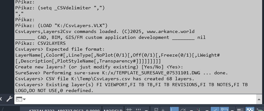

    Posted: 25.Mar.2025 at 07:56
Here is the DWG file and the screen with prompts.

Direct Link To This Post Posted: 24.Mar.2025 at 15:24
I have tried to import your CSV file into your DWG and it has completed successfuly.

Direct Link To This Post Posted: 24.Mar.2025 at 14:46
I see. Please load the new version from Download - it will show what delimiter it expects in the CSV2layer command (it is aligning the delimiter to your Windows settings to keep it compatible with Excel).
If it is not "," - you can either change it by pasting the above LISP command into your AutoCAD command line, or you can change the delimiter you are using in the CSV file.

Direct Link To This Post Posted: 24.Mar.2025 at 14:08
Do you use German version  of Windows? Your list delimiter is probably set to ";", not to ",". Try to use this LISP command before you import the CSV file:
(setq _CSVdelimiter ",")
