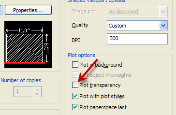

It will take longer via the Plot menu transparency box however, especially in larger and more complex drawings.  So this is where John's suggestion to use a custom Plot Style and screened colors may end up being faster and more efficient.  But both ideas work.

Thanks Dave. The transparency works.
I've been wondering why AutoCAD has transparency if we can't plot it. But now I know that we can.

You can plot transparency... but it does require conversion of vector to rastor and it does take longer.   And that's why we almost always leave the "Plot transparency" box unchecked in the expanded Plot dialog.
But if you check it you might get what you're after.

I don't believe there is a way to "plot transparency" because AutoCAD is a vector based program not raster based.
If you need transparency then you might want to look at bring your drawing into a program like Sketchup.

Interesting. I never use screening before. So we use screening to plot objects transparently? Basically it just reduce the amount of ink when we plot.
Is there a way to really plot object transparently? When I plot the drawing to PDF/DWF the color is faded but still not transparent.

The xrefs are on their own layers aren't they?
And these layers have their own color don't they?
And under Properties, when you edit the CTB style you are using, there is a separate line that reads"Screening" right?
And the default setting is 100 which means you could change that value to something less than 100 right?
You do kind of see where this is all going don't you?
Yes/No/I don't know?
