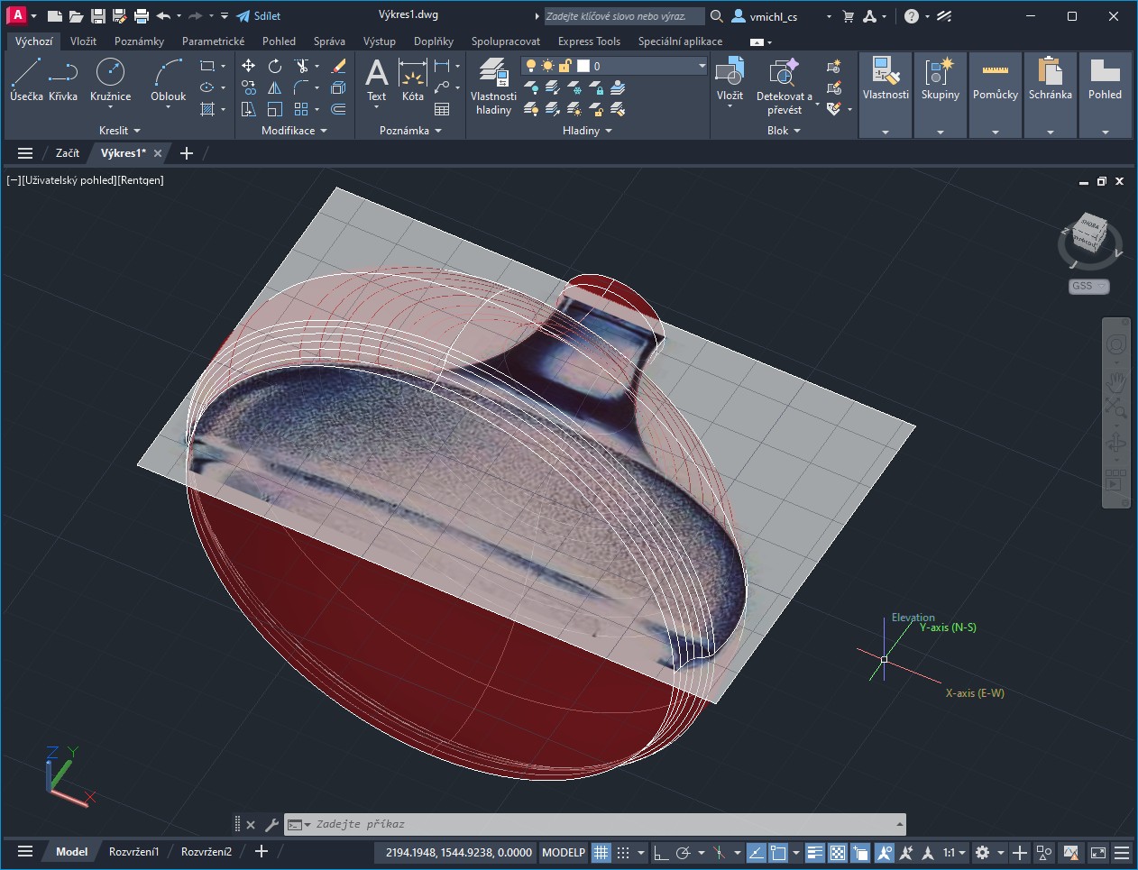

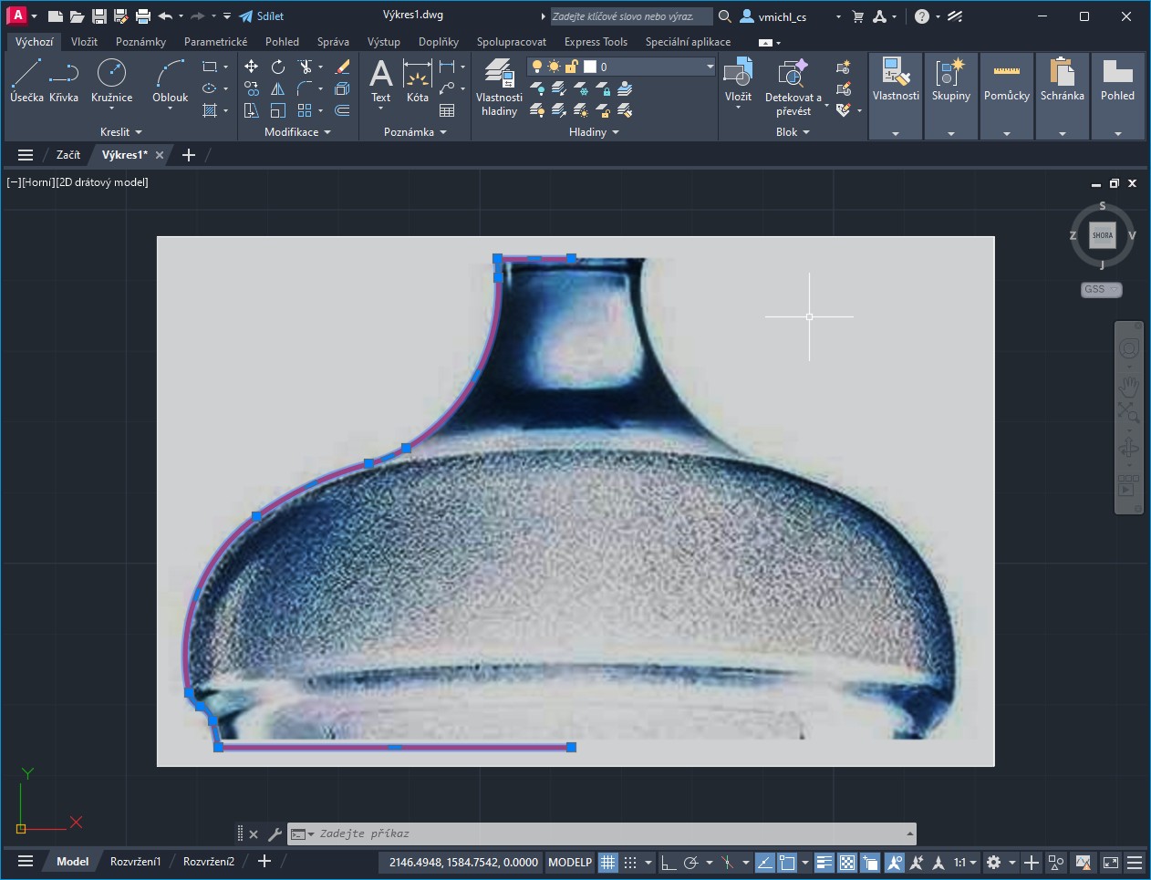

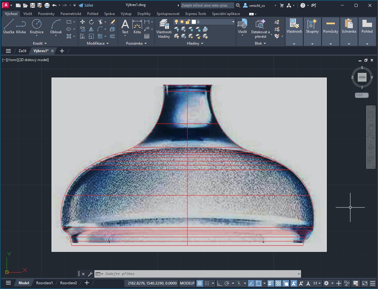

Post Options Post Options   Thanks (0) Thanks(0)   Quote Vladimir Michl Quote  Post ReplyReply Direct Link To This Post Posted: 07.Jun.2026 at 12:41
Here - IMAGEATTACH, PLINE, REVOLVE, SCALE
Edited by Vladimir Michl - 07.Jun.2026 at 12:57

Post Options Post Options   Thanks (0) Thanks(0)   Quote Vladimir Michl Quote  Post ReplyReply Direct Link To This Post Posted: 08.Jun.2026 at 12:35
There is nothing much to add - attach the image (IMAGEATTACH), while zooming, draw the polyline along the borders with the PLINE command (using the Arc or Line options where neccessary), add the horizontal segments pointing to the axis (JOIN), REVOLVE the polyline along the vertical axis, SCALE the model to real dimensions.
