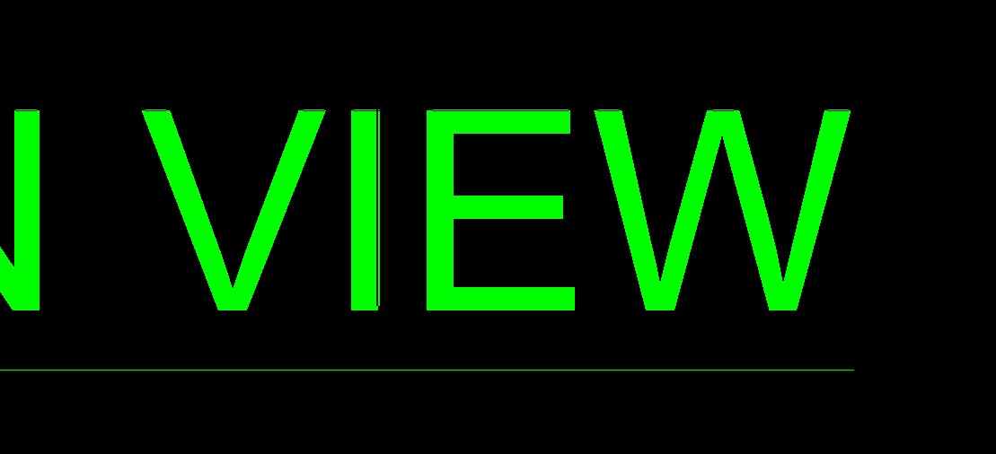

Thank you so much for that . I had an idea that it was a Hardware vs software issue. We had a similar issue with Bluebeam and crazy graphics. Switching that to Software fixed the problem too.

Try to tweak the graphics acceleration options in _GRAPHICSCONFIG or try to completely disable graphics acceleration. Your windows graphics driver may need an upgrade (or downgrade) to a different version.
Try to set the GFXDX12 variable to 0 to switch to DirectX 11.

Good day all. Recently I have been having an issue with my graphics display. When running Civil 3D, my arial font shows up with broken lines looking like missing pixel rows. Any help would be greatly appreciated. My IT Guys are stumped.
My work supplied computer stats are:
Processor 12th Gen Intel(R) Core(TM) i7-12700K   3.60 GHz
Installed RAM 32.0 GB (31.7 GB usable)
System type 64-bit operating system, x64-based processor
Video Card     NVIDIA RTX A2000 6 GB
Edition Windows 11 Enterprise
Edited by BigMikeLV - 11.Jun.2025 at 16:00
