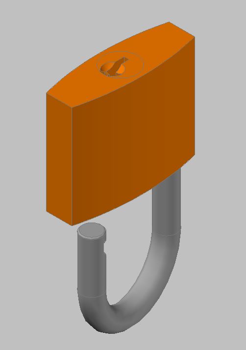

- My new and improved version. The shank has been notched which you can plainly see. What you can't see is the "catch" inside the hole where the shank goes when it is depressed and on the bottom I added the hole for the key. The body of the padlock is on one layer and the shank on another. |

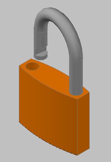

- A view of the bottom. |
