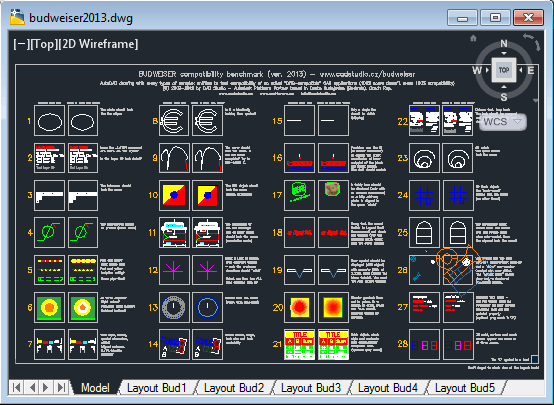

Open the BUDWEISER.DWG file in your CAD application and check the individual tests #1 to #28 on the Model tab and all the Layout tabs. If you have a password-protected Budweiser.DWG file, the password is "budweiser".
  • #1: 3D/ellipse test - circle with a 3D normal vector should look like an ellipse
  • #2: Layer test - DWG file can contain unlimited number of layers; are all the layers there? ("Test Layer 01" up to "Test Layer 99") Locked layers ("Test Layer 99") should be faded.
  • #3: Tolerance symbols - the Tolerance object should display all tolerance symbols and frames
  • #4: Font/precision - is the highlighted intersection precise? Zoom close to find any gap or overlap.
  • #5: Linetypes/Multiline - can you see red-yellow lines? (thick and text-labelled), can you see the green "pipe" linetype?
  • #6: Draworder/hatch/color/transparency - can you see the same filled areas and colors? The pentagon should be in orange (not red in 2013) and have a black (or white) border. The green square should have a black hatched bottom bar (associative hatch).
  • #7: Text/font test - check the formats and precise alignments.
  • #8: 3D/display/clipping - the Euro symbol should look exactly the same, no additional or missing lines.
  • #9: Spline/Polyline - the freehand shaped curve should look the same; the red line must be complete and the ends should touch precisely.
  • #10: OLE objects - the yellow-red-blue square should look the same (except for the pixelation - ignore)
  • #11: Complex test - Dimension/MLeader/Fields/Annot.scales - all parts of the dimension and leaders must look exactly the same
  • #12: Polar trace/Groups - this is not a visual but functional test: try draw a line from the center - the angles should "stick"; if you select a single line, all lines are selected
  • #13: Linetypes/Point type/Draworder - the complex linetype, the donut and the point type should look the same (color, scale, draw order).
  • #14: Blocks/mirroring/UCS - all attributes (texts) should look the same
  • #15: 3D/clipping - the 3D object should be visible only as a single line
  • #16: Precision - use any ID-like command to find the coordinates of the line endpoint (circle) - the results should be exactly the same. The automatically generated field (blue) should display the X-coordinate.
  • #17: Raster images - of you are online, you shoud see an image of a teddy-bear face clipped to a green freehand curve. (image should refer the cadstudio.cz web)
  • #18: Fancy font - standard AutoCAD font set contains also some fancy fonts; this test also points to the additional test in the Layout tabs.
  • #19: AEC object - wall and doors object from AutoCAD Architecture (ADT)
  • #20: Gradient - a smooth circular gradient going from red to yellow.
  • #21: Table/Computed cells - a table object should look the same (ignore possible gray masks - optional field mask). If you change any cell, the totals are recalculated automatically.
  • #22: MText/columns - some typical cases of MText justification and columns - all texts should be formatted exactly the same, including the tabbed numbers and strikeout text (please notice the paragraph indentation)
  • #23: Spiral object - the spiral should look the same
  • #24: 3D Mesh object - the face-smoothed and clipped 3D cube should look the same; the added cone should be clipped completely off.
  • #25: Parametric block/Wipeout - the parametric block should display and behave properly. Check the display match (dashed lines) and the parametric behaviour: the block should have a single grip and rotate when scaled. You should always see only the upper half of the circle when grip-editing.
  • #26: Symbols - both blue light symbols should be visible, not the camera symbol. The black "daisy" (flower) symbol is a geo-marker. All sizes are view-dependent, so any differences in the scale of the symbols are OK. These symbols are not printed.
  • #27: Fields - automatic texts are an important part of many AutoCAD drawings. The black texts should match. The red texts must DIFFER (otherwise the fields are not updated properly).
  • #28: 3D objects - 3D solid (blue), 3D surface (magenta) and 3D mesh (red) should look the same.
  • Corner "X" symbol: should be within the corner box.

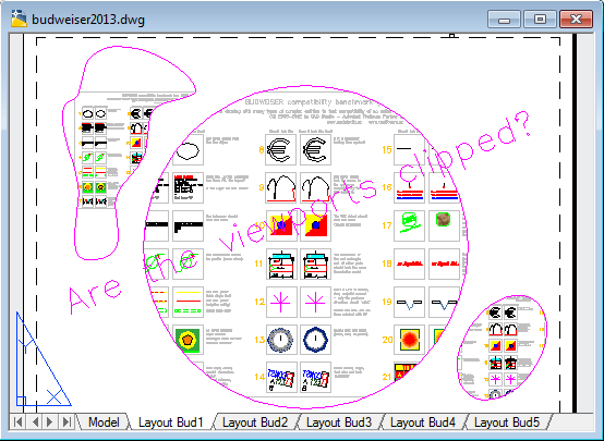

  • Layout Bud1: are the three irregular viewports properly clipped?

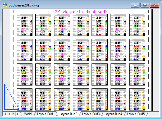

  • Layout Bud2: are all 28 viewports fully displayed and clipped?

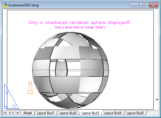

  • Layout Bud3: is there only a rendered checkered sphere (and a light symbol)?

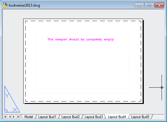

  • Layout Bud4: this layout should be completely empty (except this text)

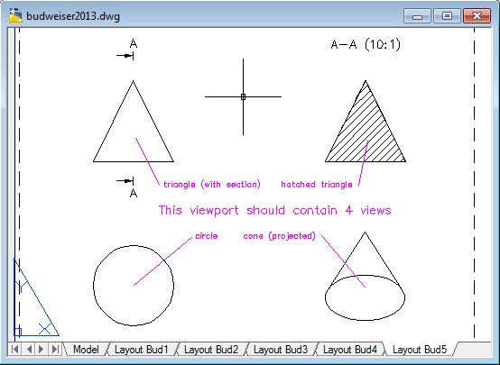

  • Layout Bud5: this layout should contain associative views depicting a 3D cone (2013 only)
