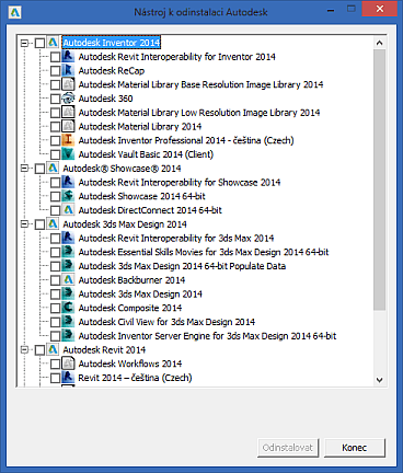

Easier uninstallation of Autodesk Design Suite applications.
A - answer Since version 2014 you can more easily uninstall individual products and products of the Autodesk Design Suites (Building Design Suite, Product Design Suite, Infrastructure Design Suite, etc.). So if you e.g. upgrade to a newer version, or you need to batch-uninstall a trial version, you can now use the new "Uninstall Tool". No more manual sequential uninstallation of all individual applications.
This tool can be found in the Start menu, or in the folder \Program Files\Common Files\Autodesk Shared\Uninstall Tool\. You can choose which apps to uninstall:
BDS uninstall
DesignSuite2014InvRevitmax
