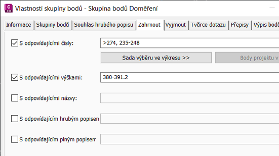

If you need to create a point group in the Prospector in a Civil 3D project, that matches specific criteria (e.g. a range of point numbers, elevations, etc.), you can use the Point Group property settings.
On the Include (or Exclude) tab, specify the desired criteria, such as a specific value, a range from-to, or an expression for the specified value, such as >NN, or a list of conditions. You can filter points higher than the specified height Z, points with a number in the range N1-N2, etc.
Multiple specified criteria are bound by the AND condition, comma-separated values are bound by the OR condition.
