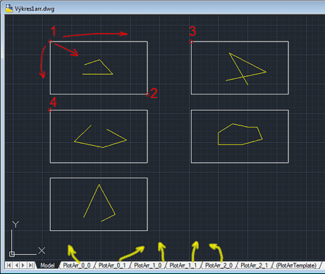

In all cases, the application first prompts for the shape of the rectangular array with the "drawings". You will sequentially specify the top left point (1), the size of a single frame (2), the distance between columns (3) and between rows (4), the number of columns and rows (see the picture). Possible missing frames - frames with no content - are ignored (not plotted).

As a result, either a respective number of plots is printed, or a series of numbered layouts or DWG files or a set of page setups is created. The generated layouts are created from the layout template "(PlotArrTemplate)" (rename an existing layout to this name). In this template you can predefine the viewport size, its scale, page setup, etc.). You can then plot this series in one go using the PUBLISH command. Similarly, the pcDWGarr creates page setups and automatically publishes these setups to the output device defined in the page setup template ("PlotArrTemplate").
