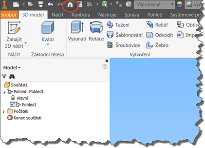

In Inventor, you can temporarily disable the Home screen in the Application Options:
Even if you have your Home scree disabled, you can invoke it if needed through the Home icon:
