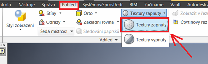

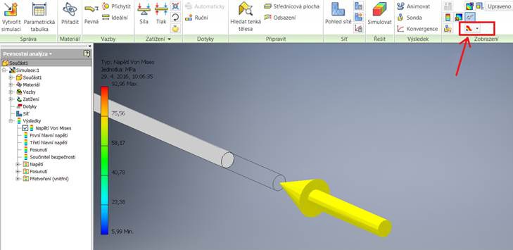

After you complete the FEM simulation calculation in Inventor, the graphical (color) representation of the results is not displayed on the model - despite you have enabled model shading.
Possible solutions:
  1. Check that your graphics card driver is certified for Inventor
  2. Exit the simulation and check if you have textures enabled on the Display tab:
