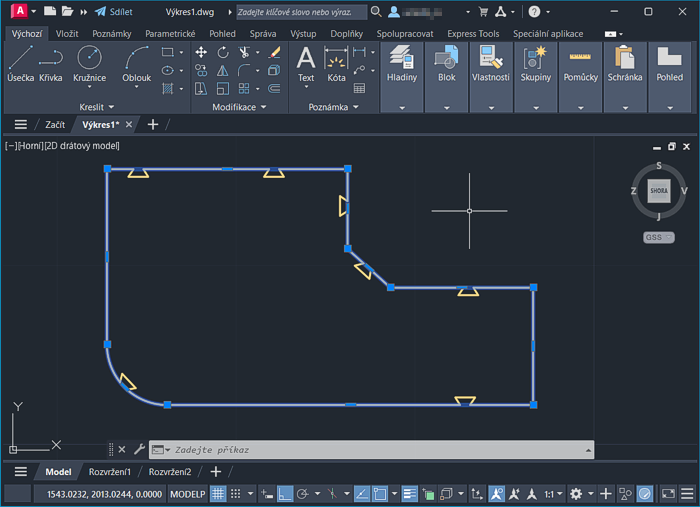

If you need to display a certain symbol in an AutoCAD polyline outline at specific points, e.g. a connector, a type designation of an assembly point or a notch or cutout interrupting the curve, it is often necessary at the same time to preserve the original shape of the polyline - e.g. for export to a cutting machine, for length and area reports, etc.
These conflicting requirements can be quite easily resolved by combining a dynamic block with automatic alignment and a wipeout object.
The result can then look like this:
Notch on a polyline

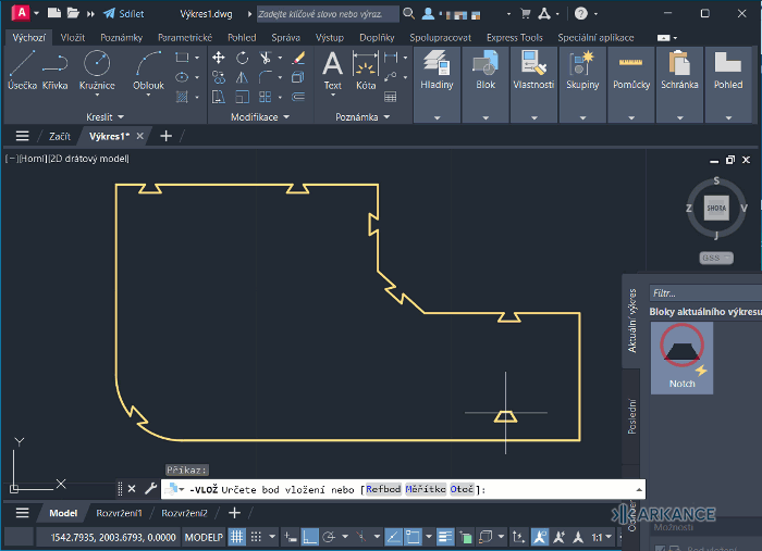

There are several rules to follow when creating and using a dynamic block like this:
  • in addition to the block shape graphic itself, you need to include a Wipeout entity in the block definition, with a similar shape to the block (preferably with a small overlap) - this will wipe-out the original polyline geometry
  • in the block editor, use the Draworder command to place the wipeout "under" the block geometry
  • add the Align parameter to your block (BEDIT), tangent to the detected geometry on block insertion (see the picture)
  • when using the block, the FRAME variable must be set to 0 so that the wipeout boundary is not displayed or printed
  • use the osnap (e.g. "nearest") to pick the exact insertion point on the curve; the "flip" of the inserted block is affected by the direction from which you approach the curve
Dynamic block with auto-alignment
Even after such distortions and breaks, the internal shape and properties of the original outline polyline remain intact:
