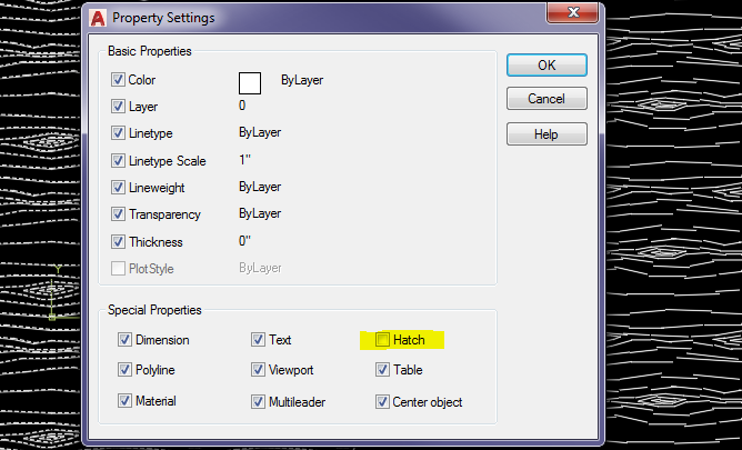

Originally posted by Zuhaib Zuhaib wrote:
Dear @KENT its not the problem of origin . its the problem of result after matching the hatch properties by using MATCHpROP.
You must have Hatch properties not selected in your MATCHPROP Settings.  Start MATCHPROP, pick the source Hatch pattern, choose the Settings option, and I suspect you will see this in regard to the highlighted piece:
The piece of Hatching visible to the left has its origin in the middle [you can see the greenish UCS icon], and the one visible to the right has its origin at 5000,5000, so it's distorted similar to your original image.
When I MATCHPROP with this Special Property un-checked, as shown, I get what you describe [the target Hatch only gets the basic properties like Layer, color, etc. matched], but if I check that button at Hatch in Special Properties, then it works as you intend [properties specific to Hatch patterns, such as origin and scale, are also matched].

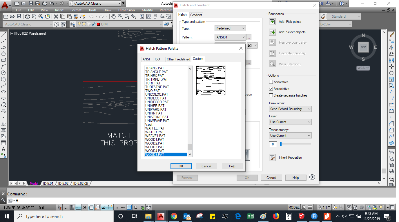

Dear Kent
Thanx for picture help but dear its still not working for me. its a custom hatch as shown in the picture. Could it be the problem of custom hatch?
