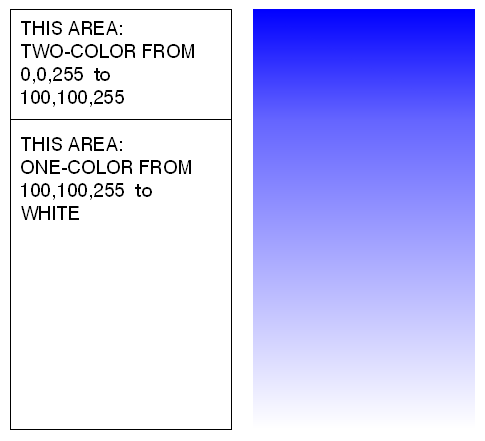

Kent Cooper
Senior Member
Joined: 12.Mar.2013 Location: United States Using: AutoCAD2020, 2023 Status: Offline Points: 687 |
Posted: 04.Feb.2014 at 20:30 |
How about an approach like this? You can vary the proportions between the two areas, or use more than two areas if that gets you the look you want. Just make sure the "end" color of one gradient is the same as the "start" color of the next one.
GerroffMe
Newbie
Joined: 03.Feb.2014 Location: United Kingdom Using: AutoCAD Map 3D 2011 Status: Offline Points: 8 |
Posted: 05.Feb.2014 at 10:13 |
Cheers Kent, I did approach it like that and it worked great. I was hoping there would be easier/quicker way, but this way although a bit time consuming did work well.
